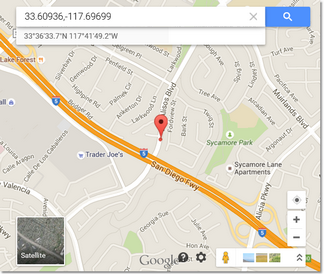

Clicking the menu File > Browser Map (or pressing Ctrl-W) will invoke your computer's default web browser to display a static map showing the current location of the camera. A marker in the center of the map shows the position of the camera that corresponds to the current video playback position. Each time you click File > Browser Map a new web browser window/tab will be invoked.

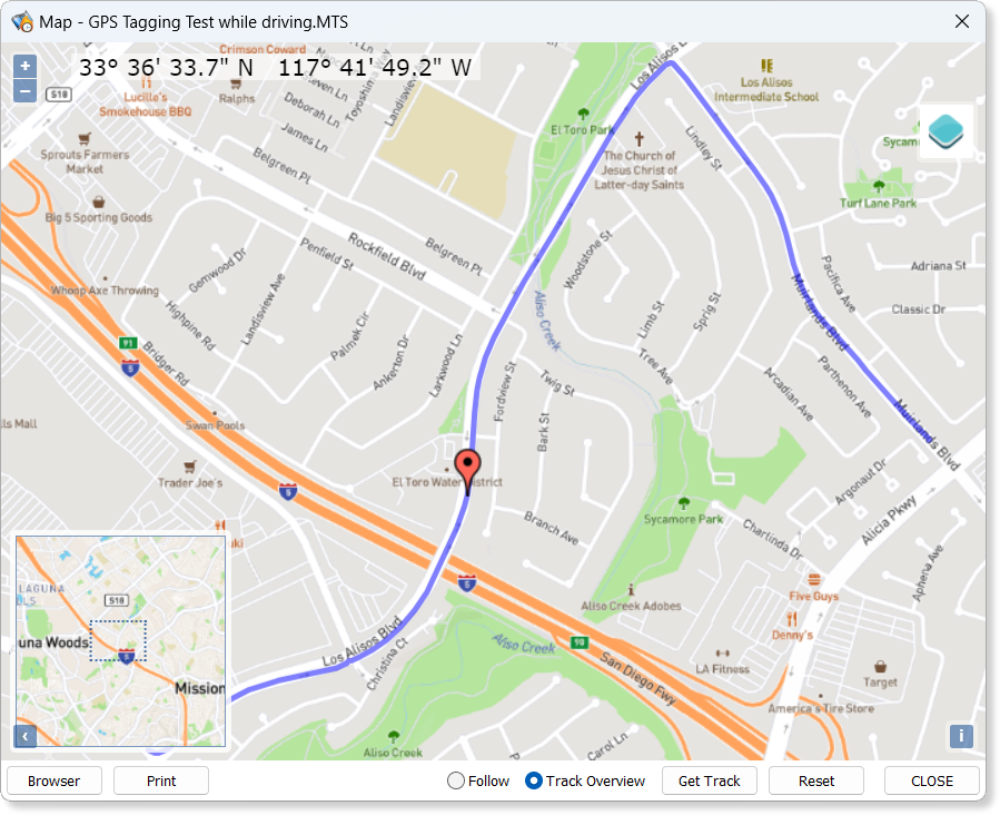

Follow view is the default. Here the marker is always in the center of the map area, and the map automatically scrolls beneath it as the camera moves.
Track Overview displays the map so that the complete track (i.e. route) of the camera is visible in blue. The map remains stationary so that the whole track is always visible. As the file plays, the marker moves along the track.
When you switch to Track Overview, the track is automatically read from a GPX file which is located in the same folder as the video file and has the same file name but with a .GPX extension. The track is then drawn as a thick blue line across the map.
If the GPX file does not exist then no track will be displayed. In that case you should click the Get Track button. The video file is then scanned and the GPX file created - the track will then be displayed on the map.
You can switch between the two views by clicking the Follow or Track Overview radio buttons at the bottom of the Map window.

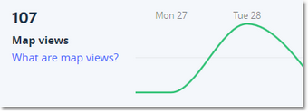

In your Mapbox account, click Statistics and you can view the current number of Map Views used up this month - beware that the total displayed is not in real-time so it may be delayed by several hours. You should check this on a regular basis. If you no longer wish to use your account, click Settings and then the Delete button.
